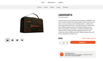

Potential alternative path, get a smaller and basic lithium for about the same price as an AGM, then upgrade to something nicer/larger later.
EcoWorthy are a not terrible brand, no frills and need a freezing charge cutoff (which you should have) and the 50aH will give about the same usable capacity as a 100aH AGM for £140 currently.
Thing is the AGM will take all the space right now, meaning you need to move kit that will stay long term to less ideal places, and when you replace with a nice 105aH Roamer you will have a gap...
That's the best way to do it, just check which way around the potential LiFePO4 battery has it's terminals, you might find they're the opposite to your AGM which makes putting wiring in with the plan to upgrade, tricky! Also, ring terminals for the battery terminals, as you don't want to be re crimping a battery cable under the seat.
If you spec everything for your planned LiFePO4 battery then when the time comes, you should be able to just lift out the old battery and put the new one in.
