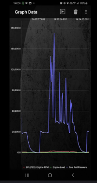

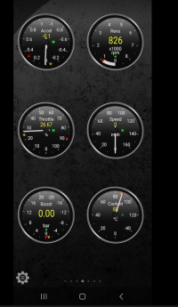

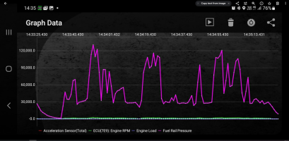

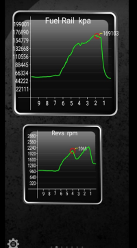

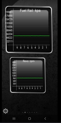

i plugged in Carista today and graphed some nice plots on the Torque APP . . .
of Engine RPM vs Engine LOAD, vs Fuel Rail Pressure.
1678986642493.png1678986661068.png1678986699280.png1678986688294.png1678986669677.png
from these we can see, . . .
Engine tick over @ 900rpm we get about 30,000Kpa rail pressure.
accelerating with engine load we can see upto 170,000Kpa,
during stop / start SHUT DOWNS rail pressure bleeds down to 0Kpa ( 300Kpa)
so NO Rail pressure.
during stop / start RESTARTS. - rail pressure rises to over 30,000Kpa almost instantly

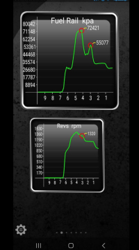

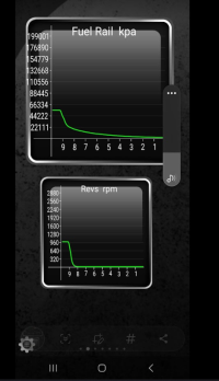

additional graphs showing instant rise of rail pressure. . . .

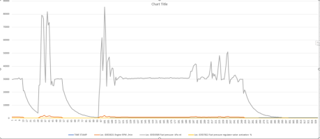

charting your data the plot looks similar . . .
tick over rail pressure about 30,000Kpa
Load acceleration > 90,000Kpa or higher
shutdown event - <900Kpa
Reactions: mmi
vs the 27200 value from a known good start . .
