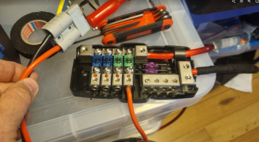

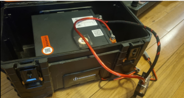

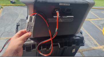

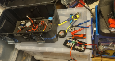

@benp1
im using a MIDI fusebox thats connected to the battery,
in that fuse box i have two 50A Anderson connectors.
then i made up a SB50 to XT60 cable.
see here:
both these batteries use Lifepo4 cell tech, and have internal BMS for safety.

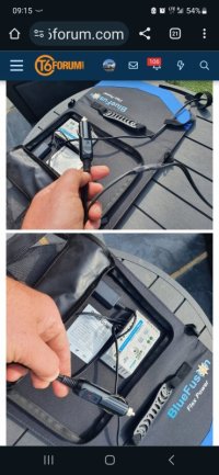

Brought the bluefusion 50w kit to keep the main battery topped up.
Having seen lots of pics with this on the dash, I naively assumed it would plug straight into a 12v cigarette socket.
However reading the small print it's crocodile clips.
How are people connecting this up with the panels in the cab?
What am I missing?
